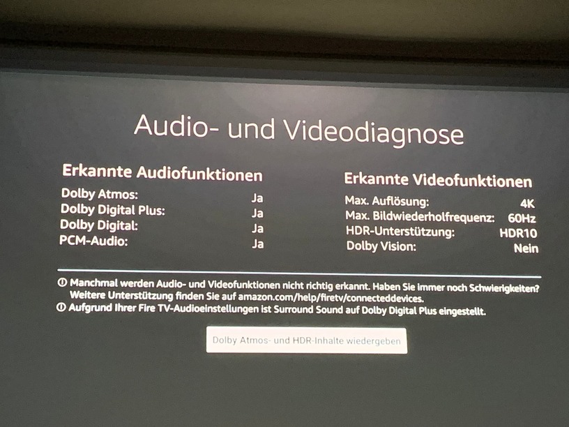

Ja = Yes, Sorry but the picture is in German :slight_smile:

When I play files via Plex i get only sound from the front (I think stereo), my soundbar told me Dolby Digital is coming in. The diagnostic from Fire TV 4K Max tells me everything is right connected and the Dolby Atmos Demo from the Fire stick is amazing. Also wenn I Play UHD Disks from my UHD Player everything is Fine. Netflix and Amazon content also uses my surround system.

When I enable HDMI Passtrough then on every video I get an error and no video could be played. Ac3 or EAC3 with 5.1 or 7.1 is not played. If I deactivate the passtrough then every file plays fine at direct play (even if it is not TrueHD, which the stick don’t support). But that’s OK, a „normal“ 5.1 surround sound is enough what I need.
I tried it on another TV with another Fire TV 4K Max and when I enable the hdmi passtrough I get the same error. There is just a cheap 2.1 soundbar connected via HDMI-Arc through the TV, these Fire stick is connected via the television.
