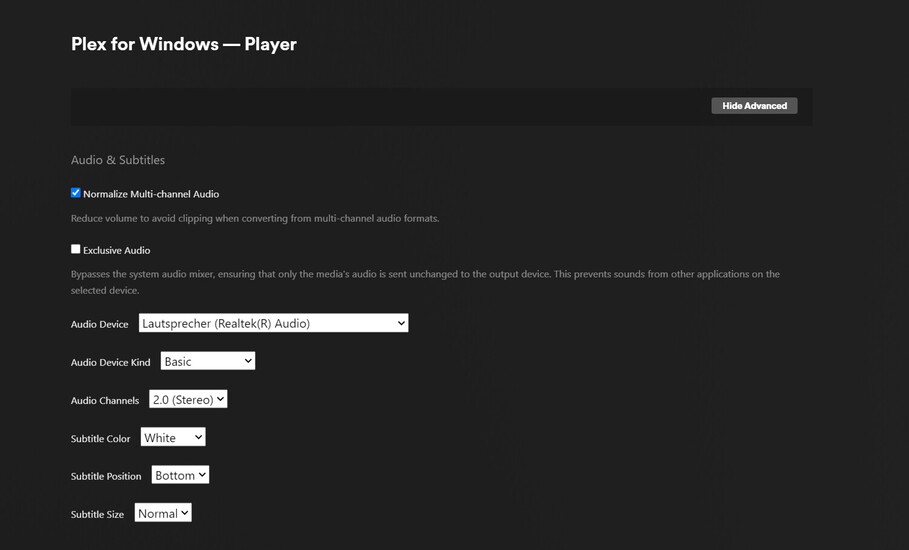

Have you configured your audio to be stereo-out?
Have you tried configuring audio output via mpv.conf?
Thanks, that does seem to work also if I set it manually with that menu, no idea on mpv.conf…considering everything on this system otherwise (speaker type in sound settings, device manager, etc.) is explicitly set for 2.0 stereo though, i’m still a tad confused why just leaving it on Auto doesn’t do the trick.
