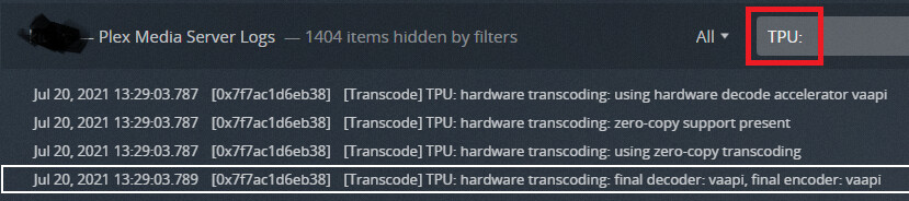

You can verify the GPU used by a) looking in the log files or b) filtering in the console (Settings → Console).
The relevant line contains TPU: and lists the final decoder & encoder. The list of decoder/encoders is in the Tech Specs section of Using Hardware Accelerated Streaming.
Example from PMS on my Synology NAS (Linux) showing Intel Quick Sync used for decoding & encoding:
