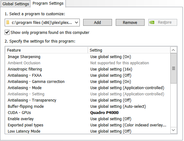

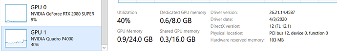

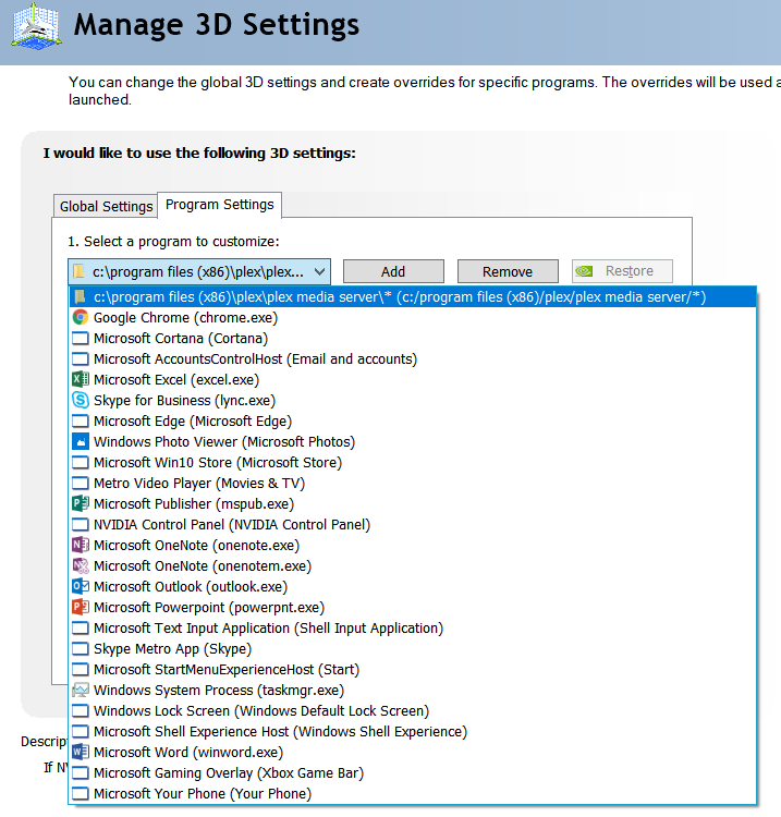

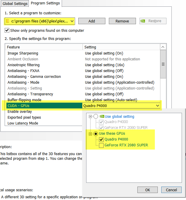

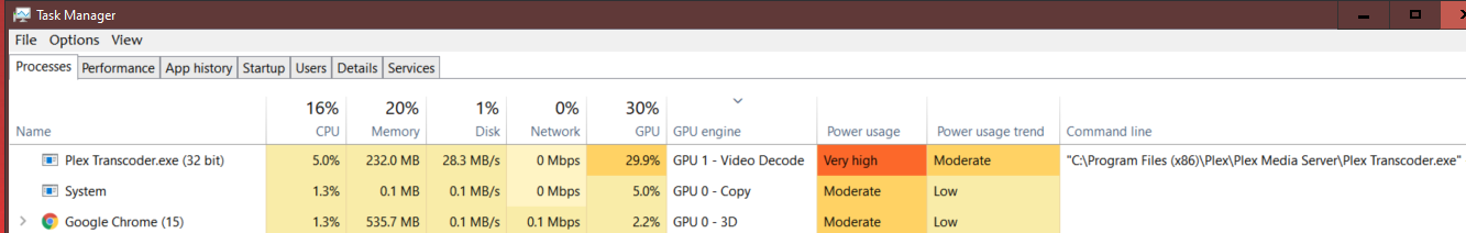

Just added the Nvidia P4000 GPU to the mix with RTX 2080 Super and see if Plex would work with 2 GPUs, well…, Plex only using 1 GPU for transcoding. Just for the sake of testing, I’ve set Plex Media Server to only use the P4000 GPU for transcoding it is working correctly. The other Nvidia RTX-2080 Super card is set for other video processing and it is working as well, Plex didn’t use this card for transcoding at all. I have no display connecting to the P4000 GPU at this time. I hope this help someone want to do this way. BTW, I’ve also unrestricted the RTX-2080 Super limitation to for more than 2 transcoding and it is also working. Here are some pix to show some details.
Good luck and be safe :slight_smile:
What is that program you’re using to change 3D settings?
