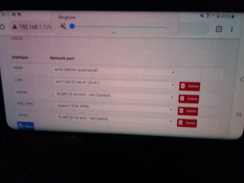

but my plex dosent match my port foward
Looks like you create a rule by hand ?
No need to do that.
yes I have vlans
I have 2 vlans.

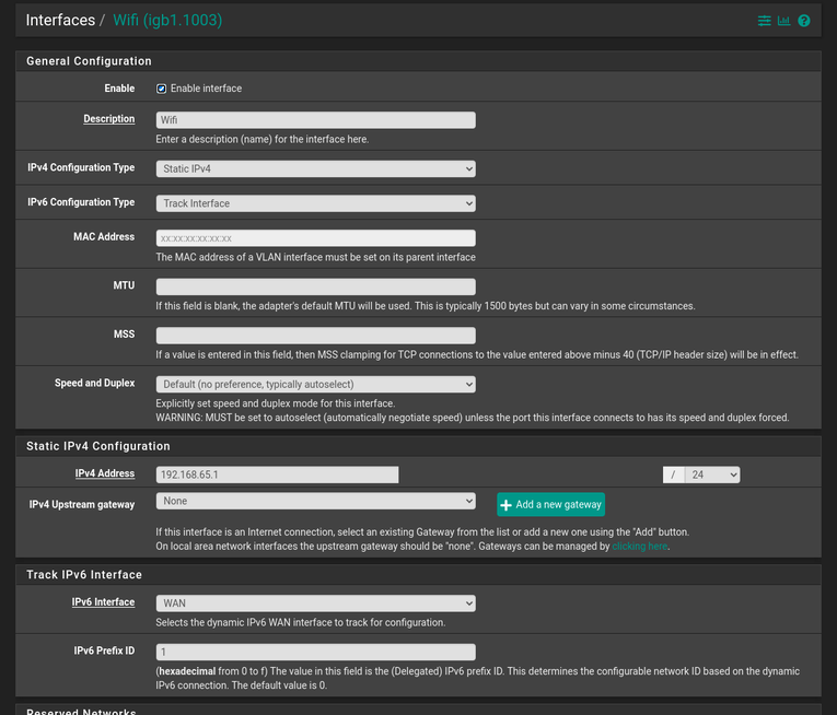

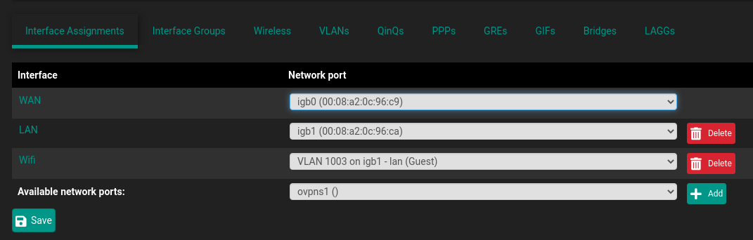

Here’s my one VLAN (Guest WiFi is isolated from everything)
there is no need (IMHO) to micro manage a home LAN behind a pfSense.
Interfaces:
Assigning and VLAN tagging.

If I wanted more VLANs (subnets), I would make the adapters here.
yes, The only reason for the 2 subnets is that i use “eye pee tee v” and the isp throttles that. but amazon prime doesnt work on the vpn, ergo the 2 ssids are easy to switch on a wifi device.
