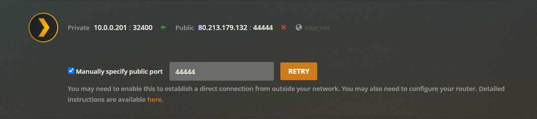

It’s working fine locally. I needed to alter the way pfSense did the port forwarding to allow Plex to access the server through my WAN address when using plex.tv
My setup on the server looks like this:

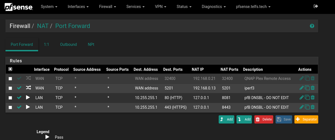

When all said and done, the NAT rule table, for all forwarded traffic, will show the two key templates:
  1. * for all Source addresses (you limit this to specific hosts if you wish)
  2. * for all Source ports – since port number from the source always varies.
This shows:
  1. Any source, Any port → PMS :32400 → internal 32400 (I use a much tighter spec)
  2. Any source, Any port → port 5201 (at firewall) → iperf server at port 5201

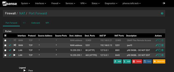

I was unaware of the difference in pfSense between WAN net and WAN address. After i read up on it the difference makes perfect sense. I have now tried re-creating the NAT rule by replacing WAN net with WAN address. It has made no difference whatsoever. Internally and in the logs I can see that PLEX is making other connections externally just fine through UPnP, but I would prefer to handle the port forwarding myself. I just don’t understand why this is not working on my end. From what I’m seeing in the logs it’s almost like pfSense is seeing no traffic on the port assigned to PLEX directed at my external IP whatsoever.

if no traffic is coming to the PORT you specified, check what you set in Remote Access - Manually Map port. Stop & Restart Remote Access if unsure.

PS: Having now tried to do everything manually (using aliases for simplicity) I am still not seeing any sign of traffic on my external PLEX port:
So apperantly the issue was not pfSense. My initial configuration worked just fine once I altered the NAT destination from WAN net to WAN address. What was causing the issue was the local firewall on the PLEX server. Apperantly packets are fordwarded with different meta-data through pfSense compared to my ISP provided router. Most likely the original sender is maintained as the source of the packets by pfSense, but not by the router provided by my ISP. As a result packets was blocked by the local firewall on the server which were set up to only allow traffic originating on the LAN subnet access on port 32400. Giving public addresses access solved the problem. If anybody more knowledgable than me can say exactly why this is the case that would be awesome as I would like to implement a stricter local rule if possible.

pfSense (2.4 or 2.5) responds perfectly to PMS requests.
In this configuration, you see:
  1. My Synology Development system
  2. My main PMS
  3. My Docker test system
  4. My workstation

Why are your external ports different? Also is source the internal portand destination the external? See a guy needs clarity here.
The external ports are different because PMS is selecting a random port.
(I have 4 active servers)

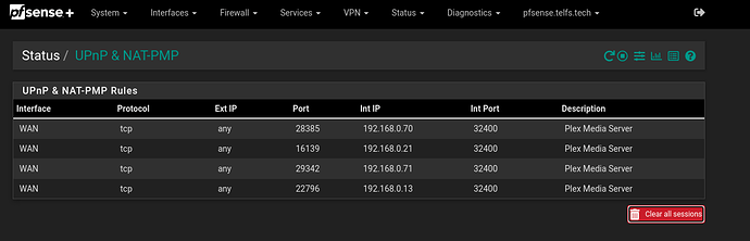

Are you talking about the NAT port fowarding rules? Case that what I’m talking about. but I dont even know haw to get to that screen you showed ealier.
Status → UPnP & NAT-PMP (at the bottom)
this is where i am. sorryfor the bad quality. using my phone and I have big fingers.
