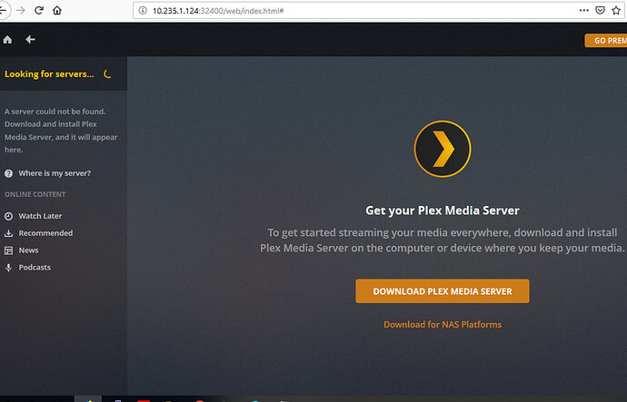

freeNAS PMS Plugin says "Looking for servers"
Server Version#: 1.13.8.5395
Player Version#: NA
This is my first crack at using PLEX media server. I just put together a 16tb freeNAS (freebSD) storage server. I installed PMS version 1.13.8.5395 from the add ons page. My problem is that when I go to the management web gui for PMS it just says “Looking for servers” and “A server could not be found. Download and install Plex Media Server, and it will appear here.” The jail that the PMS is running in has correct permissions and is connected to the movie folder I have.
I have no idea what to even try at this point. Like I said this is my first time ever trying to use PLEX so any help at all would be greatly appreciated.
PS: I’m running freeNAS 11.2
I am having the same issue. i have tried 11.1 u6 and 11.2 RC1. Same issues
Same problem. I’m running 11.2 stable.
Same issue as well 11.2 stable I’ve tried over jail versions and gotten nowhere. When I go to uninstall plex are there other directories or preference XML files that also need to be deleted?
I’m having the same issue. I’ve tried fresh installs of both the Plex Media Server and Plex Pass versions on my FreeNAS box running 11.2 release U1 and can’t see or configure the server running in the plugin, just the Windows laptop I’m trying to migrate away from and another Plex server shared with me.
Same problem here. Its not a router firewall issue as the server is open to the world right now. Its frustrating, but glad to know I’m not alone. I already posted a thread here, but re-upping this one so it gets noticed.
