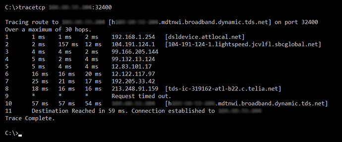

You need to tracert to the specific port on your server to see if its dropping that particular port somewhere along the path.
Windows does not natively allow you to trace to a specific port.
Use this guide to help install the tools and let us know the result.
Success!
DDimit - Thanks for the help. I downloaded and ran the tracetcp tool. Other than a hiccup on hop 9, it was making it to my IP address just fine.

Here are the tracetcp results
