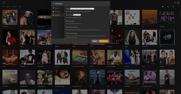

  1. is sonic analysis check in my library? See pic below

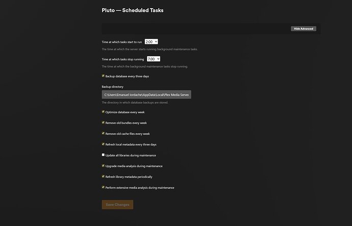

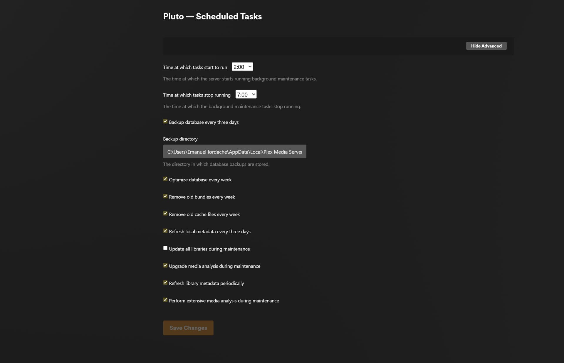

  1. Am I sure I am doing it as a scheduled task? See pic below

Settings - [server] - Library - “Analyze audio tracks for sonic features”
Ensure it is not disabled.
Properties of the library (your first screen shot, just scrolled down further)
“Popular Tracks” must be activated. It is used by many DJs and Radios.
P.S. You should disable “store track progress”. This is for podcasts and audio books, but not for regular music albums.
Also you haven’t showed us what Plexamp looks like. The icon should show up without sonic analysis but it is a premium feature.

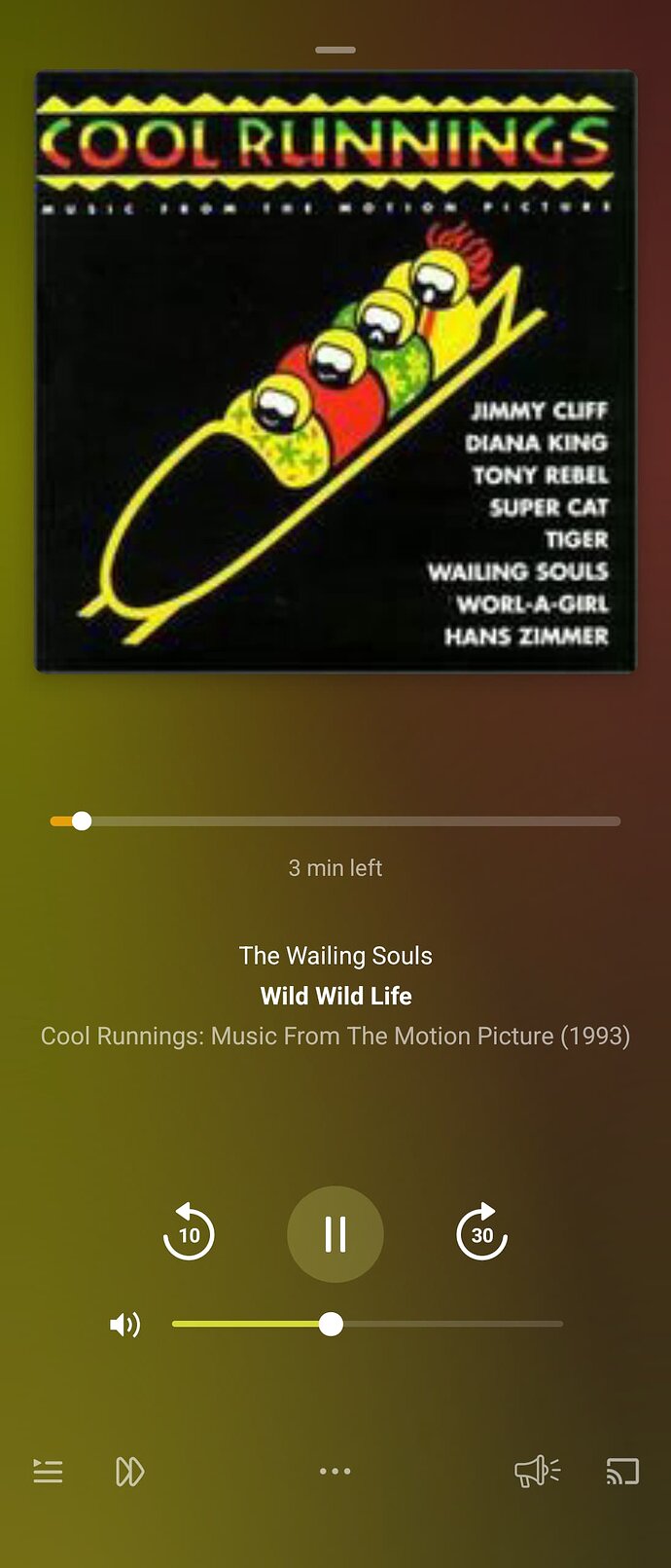

Thank you, Elen, if you ask, it shall be done. As you can see the Guest DJ icon is not at the bottom of the screen where it would normally be.

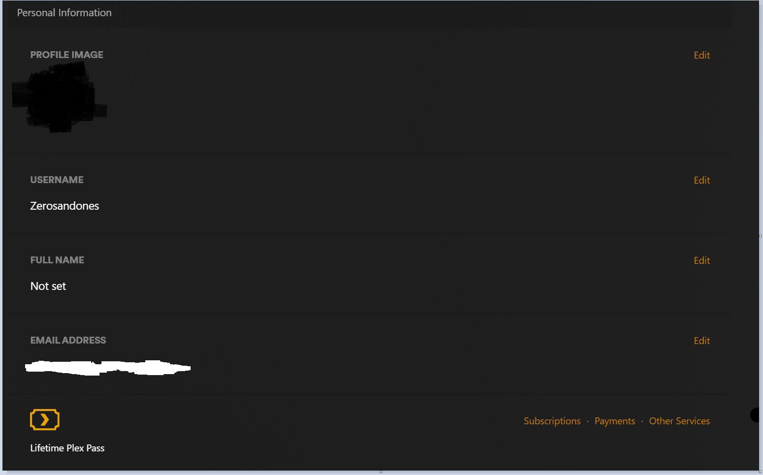

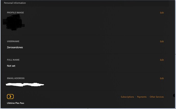

Also just to try to be as thorough as possible since you mention it is a premium picture here is a picture of my plex account showing my lifetime plex pass

The issue is that you have the long form player setting enabled, as well as Store Track Progress. This is just not correct for music. Turn off Store Track Progress and you’ll get a player back which has the DJ button!

So I turned off the track progress and the dj icon did not show up. I even tried restarted the app. Didn’t work. Restarted my phone, no go. I re-read again on what you posted and decided let’s just turn off long-form controls. Soon as I did that in conjuction with turning off track progress, guest dj icon showed up.
I went back and turn on long form control. I took pictures of the player with it on and off and could not tell the difference.
So what I am asking for here is a bit of education if possible? What is the difference? Why even have it, if the players look exaclty the same? How were you able to know I had long form control on without me showing all my settings?
Thanks elan for the assist.
The main different is the seek bar is set up for super long tracks, and allows for precise seeking. In addition it has smart silence elimination and voice boost.
