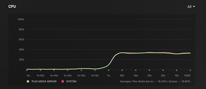

I am currently migrating my plex setup from an Odroid H3+ (Jasper Lake N6005) to H4+ (Alder Lake N97). I have gone through the process of backing up, reinstalling Linux, restoring, etc. To be clear, Plex says it is doing hardware transcoding but I am using way more CPU than I am used to (unless I am mistaken). I feel like the H3+ did hardware transcoding around 12% of CPU and the H4+ uses closer to 40%.

Plex says it is hardware transcoding and here is a screenshot of that.

  1. Yes, your logs are showing HW transcoding
Sep 02, 2024 21:18:41.049 [140632902884152] DEBUG - [Req#318a/Transcode/82985ABD-FB5C-46D8-9DBB-73107DAA6415] [FFMPEG] - Created surface 0.
Sep 02, 2024 21:18:41.049 [140632902884152] DEBUG - [Req#318a/Transcode/82985ABD-FB5C-46D8-9DBB-73107DAA6415] [FFMPEG] - Direct mapping possible.
Sep 02, 2024 21:18:41.051 [140632902884152] INFO - [Req#318a/Transcode/82985ABD-FB5C-46D8-9DBB-73107DAA6415] Preparing driver imd for GPU Alder Lake-N [UHD Graphics]
Sep 02, 2024 21:18:41.051 [140632902884152] DEBUG - [Req#318a/Transcode/82985ABD-FB5C-46D8-9DBB-73107DAA6415/DriverDL/imd] Skipping download; already exists
Sep 02, 2024 21:18:41.051 [140632902884152] DEBUG - [Req#318a/Transcode/82985ABD-FB5C-46D8-9DBB-73107DAA6415] TPU: hardware transcoding: final decoder: vaapi, final encoder: vaapi
Sep 02, 2024 21:18:41.052 [140632902884152] DEBUG - [Req#318a/Transcode/82985ABD-FB5C-46D8-9DBB-73107DAA6415/JobRunner] Job running: FFMPEG_EXTERNAL_LIBS='/var/lib/plexmediaserver/Library/Application\ Support/Plex\ Media\ Server/Codecs/27d3929-731e70e17b964ba367f4016a-linux-x86_64/' LIBVA_DRIVERS_PATH="/var/lib/plexmediaserver/Library/Application Support/Plex Media Server/Cache/va-dri-linux-x86_64" X_PLEX_TOKEN=xxxxxxxxxxxxxxxxxxxxxxxxxxxxxxxxxxxxxxxxxx "/usr/lib/plexmediaserver/Plex Transcoder" -codec:0 h264 -hwaccel:0 vaapi -hwaccel_fallback_threshold:0 10 -hwaccel_output_format:0 vaapi -hwaccel_device:0 vaapi -ss 3920 -analyzeduration 20000000 -probesize 20000000 -i "/media/plex/movies/Shutter Island (2010).mkv" -filter_complex "[0:0]hwupload[0];[0]scale_vaapi=w=320:h=136:format=nv12[1];[1]hwupload[2]" -map "[2]" -metadata:s:0 language=eng -codec:0 h264_vaapi -b:0 134k -maxrate:0 179k -bufsize:0 358k -r:0 23.975999999999999 -force_key_frames:0 "expr:gte(t,n_forced*8)" -map 0:1 -codec:1 copy -copypriorss:1 0 -segment_format matroska -f ssegment -individual_header_trailer 0 -flags +global_header -segment_header_filename header -segment_time 8 -segment_start_number 490 -segment_copyts 1 -segment_time_delta 0.0625 -segment_list "http://127.0.0.1:32400/video/:/transcode/session/82985ABD-FB5C-46D8-9DBB-73107DAA6415/737180f2-2533-4949-95e3-527472ae47e4/manifest?X-Plex-Http-Pipeline=infinite" -segment_list_type csv -segment_list_size 5 -segment_list_separate_stream_times 1 -segment_list_unfinished 1 -segment_format_options output_ts_offset=10 -max_delay 5000000 -avoid_negative_ts disabled -map_metadata:g -1 -map_metadata:c -1 -map_chapters -1 "media-%05d.ts" -start_at_zero -copyts -init_hw_device vaapi=vaapi:/dev/dri/renderD128,driver=iHD -filter_hw_device vaapi -y -nostats -loglevel quiet -loglevel_plex error -progressurl http://127.0.0.1:32400/video/:/transcode/session/82985ABD-FB5C-46D8-9DBB-73107DAA6415/737180f2-2533-4949-95e3-527472ae47e4/progress
Sep 02, 2024 21:18:41.052 [140632902884152] DEBUG - [Req#318a/Transcode/82985ABD-FB5C-46D8-9DBB-73107DAA6415/JobRunner] In directory: "/var/lib/plexmediaserver/Library/Application Support/Plex Media Server/Cache/Transcode/Sessions/plex-transcode-82985ABD-FB5C-46D8-9DBB-73107DAA6415-737180f2-2533-4949-95e3-527472ae47e4"
Sep 02, 2024 21:18:41.052 [140632902884152] DEBUG - [Req#318a/Transcode/82985ABD-FB5C-46D8-9DBB-73107DAA6415/JobRunner] Jobs: Starting child process with pid 1578
Sep 02, 2024 21:18:41.052 [140632902884152] DEBUG - [Req#318a/Transcode/82985ABD-FB5C-46D8-9DBB-73107DAA6415] Started session successfully: 82985ABD-FB5C-46D8-9DBB-73107DAA6415
Sep 02, 2024 21:18:41.053 [140632838921016] DEBUG - [Req#318a/Transcode/82985ABD-FB5C-46D8-9DBB-73107DAA6415] Streaming Resource: Resetting play progress due to seek
  1. This is HW transcoding, with tonemapping, and audio conversion on an N100 (AlderLake-N) as seen on my N100.
CPU load will settle down once the output buffer fills and it goes into ‘sloth’ mode (visible in the logs)
