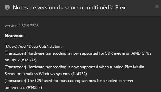

Well, I think I DID IT !!! :partying_face:
Almalinux Server Headless, Docker and GPU passthrough.
I could validate the HW transcoding on a test instance so I did the swap from the VM to the container.
It works VERY good (the host is a I5, 32 GB RAM, 1 TB SSD and 2x10GB/s in LACP for the network. I could run 4x4K streams without an issue (after patching of course). Web client works finally again.
But install drivers is a f***** pain on Linux, I hesitated to go back to an headless Windows core !!!
The only “loss” for now is that I had a reverse proxy on the VM itself to use the web client on port 443, which is now back to 32400. I could not find a way to have both unless using another reverse proxy somewhere else. Is there a way to have internal port 32400 available on 2 external ports with docker?

HW transcoding is not working here after upgrading PMS to 1.32.5.7328
Using nvidia driver 535.54.03 on Debian. PMS running in docker. HW transcoding works fine on 1.32.4.7195-7c8f9d3b6 and earlier versions.
Same issue and log messages both when I select the GPU or pick Auto
