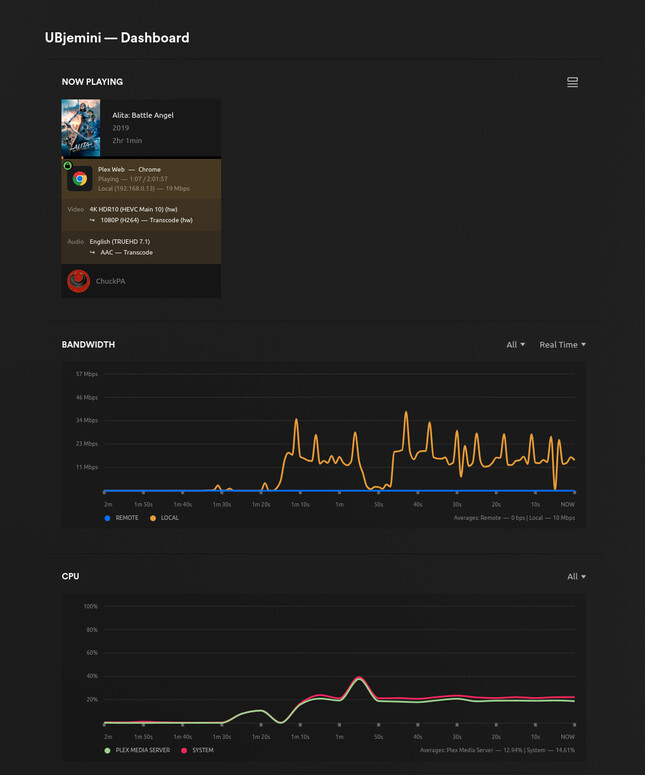

I went and updated to the latest version (1.32.8.7639, stable). I am seeing hardware transcoding working, along with HDR tone mapping. Running on J4125 (Synology DS920+), Linuxserver docker image. Great work folks

Here it is, 1.32.8 , HW transcoding and tonemapping

Version 1.32.8.7639-fb6452ebf
“UBjemini” == “Ubuntu Jemini” :slight_smile:
Tonemapping is enabled
