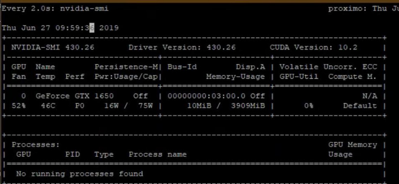

i have a gtx 1650 and I am pretty sure it idles at P0 before plex ever gets involved.
yup P0 idle 16 watts

the smi image above is just a grid layout like an excel sheet
smi version, driver version, cuda version
then column headers for the section below
gpu = 0, name = geforece gtx 1650, persistece-m = off (no idea), bus id (pcie i assume), display attached = off (attached but off), volatile uncorr no idea/blank, ecc = n/a
fan = 52% temp = 46c, perf mode = p0, power: usage/capacity = 16w out of 75w, memory/usage = 10mib out of 3909mib, gpu utilization = 0%, compute mode? = default
no processes running
later I’ll show a screen of 2 transcode running so you can seem process and memory usage, although I am pretty sure I have posted such screenshots on other threads related to linux nvdec/nvec
as far as power state, I agree it doesn’t really have anything to do with plex, its the hardware/driver interaction that determines what power mode and controls the fan etc.
