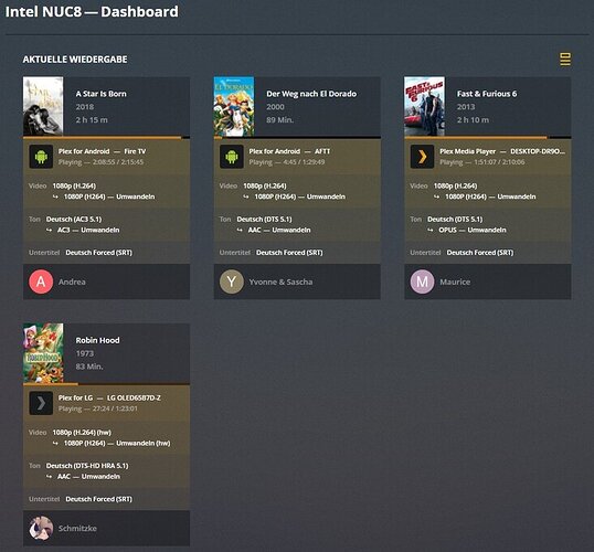

i have the same problem for months @ intel nuc8 i5
9 of 10 transcodes are without hw transcoding. no idea why.!
