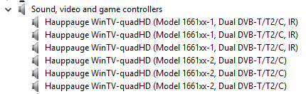

Just so you know, it shows up in device manager as
Hauppauge WinTV-quadHD (Model 1651xx-1, Dual ATSC/QAM, IR)
and
Hauppauge WinTV-quadHD (Model 1651xx-2, Dual ATSC/QAM)
since it’s basically two dual tuners for 4 total.

Please add (if possible), all Hauppauge PCI quadHD cards. I have three… Currently using ArgusTV+Plex+Kodi, but I would like to simplify setup running just Plex DVR… My cards are EU models (if there is such definition).
