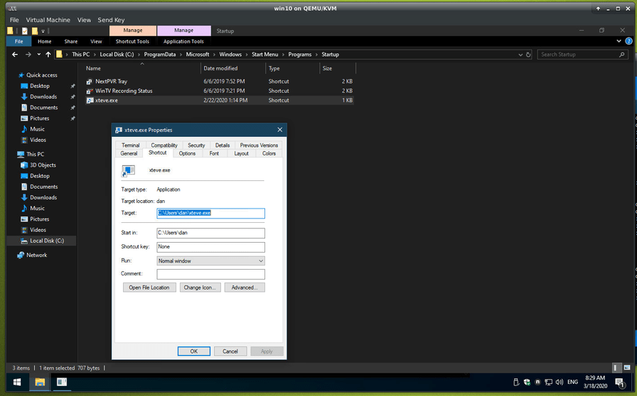

I just put a shortcut in the startup directory for Windows.. I don’t mind having the command prompt window visible since I dont use the VM for anything else…
You can also run it as a service, just download NSSM. Its an awesome Windows Service utility.

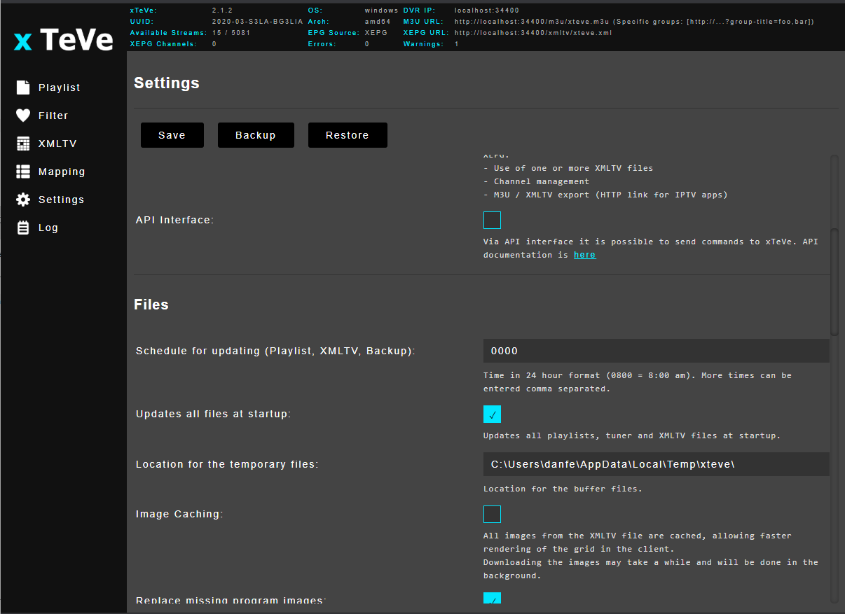

You can use the built in program, “Task Scheduler” in Windows. You can create a basic task that’ll run the mc2xml.exe once a day. Then in xTeVe, theres a setting to specify when during the day it’ll update EPG from the XMLTV file. I’d set this 15 minutes apart to allow time for mc2xml to do its thing… Just make sure when you set up Plex you pass in the xTeVe hosted XMLTV file at http://localhost:34400/xmltv/xteve.xml
