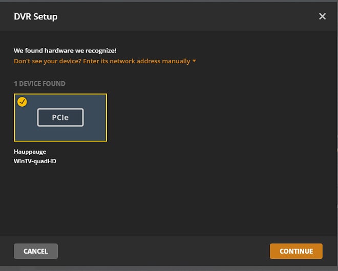

This is what plex finds when i go to live tv and dvr settings
So plex does find the tv tuner, not why it wouldn’t support it though, hopefully they get all the bugs worked out in the future.
I am using Plex DVR with no cable subscription. I have an antenna mounted in my attic and several HDHR devices on my network connected to the antenna. It is still a users decision if they will truly cut the cord and only use OTA programming. Plex provides the user the option of using either OTA or Cable TV tuners for DVR.
As far as the Prime tuner not working for you several months ago it could be that your Cable company use Copy-Once (DRM) on channels, other users on the forum have mentioned their displeasure of finding out that their cable company applied Copy-Once to almost all channels in their are. If your cable company is doing the same thing then Plex will not work with those channels. There are other users that are using Plex to record Cable TV channels using a Prime and Cable Card from their Cable company.
I don’t know whether the Hauppauge tuner will work with your Cable TV service or not. You might be running into the same issue with DRM protected channels or just encrypted channels and the tuner not having a cable card to be able to decrypt the channels.

My Plex DVR Configuration when I add my Prime with no cable card to the DVR gets less channels than my OTA as you described. With Spectrum from what I understand the number of channels Plex could work with will depend on whether you were originally in a Time Warner or Charter area. Charter tended to DRM most of the channels were Time Warner only applied DRM to some channels.
As far as handling additional tuners Plex did add a Community Supported tuner thread. The thread is pinned at the top of the DVR & Live TV forum. You may want to check out that area to see if your particular tuner is supported. https://forums.plex.tv/categories/community-tuners.

Nah my tuner isn’t supported even though plex finds it, not sure why it won’t find any channels and since hdhomerun didn’t work with plex when i tried it, i just don’t want to buy tuner after tuner trying to find one that does work.

Sounds an awful lot to me like the OP is trying to get channels from the cable company for free using clearQAM. Like many have already said, most cable companies now encrypt their QAM channels so they are no longer clearQAM. Clear meaning without encryption.
The reason the rest of the tuners he has tried don’t work in Plex is because, again, he is still trying to use clearQAM capturing when there is no longer clearQAM on his cable line. Sounds very much like he has yet tried to stick up an antenna and tried to capture ATSC signals into Plex. That is why he is not getting ANY channels in Plex.
It is completely user error in this instance and he needs to stop trying to steal cable TV from his cable company and just stick up an antenna to capture ‘Lethal Weapon’ as it is a FOX show that is broadcast completely for free over the air in his area.
