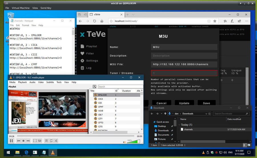

I don’t think the server authentication works on NextPVR, I’ve tried messing with it and I could still access the m3u and channel streams regardless lol. Verify everything on the NextPVR side by downloading and opening the M3U (http://localhost:8866/channels) in VLC Player and playing a few channels. Try and keep the number of channels below 480 cause xTeVe and Plex can’t handle that many..
Also verify if xTeVe is seeing all your available streams (channels).. At the top notice how I have 103 available streams.. This is the number of channels that will be available in Plex.

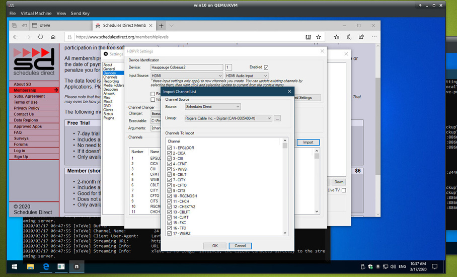

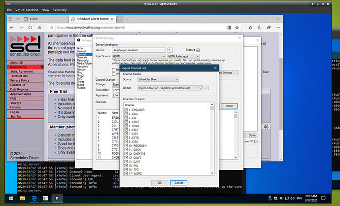

You can use the “import” feature under the device settings, and use ScheduleDirect (7 day trial is available). You’re not going to be using Schedule Directs EPG in the end tho, this is just to setup the channels in NextPVR.. During import you can batch highlight and select/deselect channels to import by pressing space. You can get away with just manually adding channels too..
NextPVR: configure your Colossus 2, configure channel lineup w/ IR blasting (manually or through SchedulesDirect), and enable http server so a M3U playlist is exposed at http://localhost:8866/channels

Thanks again for all of the help. I think I have the NextPVR service setup correctly now. I’m able to open the M3U stream in VLC and change channels easily. The only thing I can’t get configured is Plex. It fails every time when I try to scan the channels. How did you get past this point? Here’s the screen that I can’t get past in Plex. Am I entering the wrong option somewhere?
I can’t click “Continue” until I click “Scan Channels.” https://imgur.com/XmH4fJw
I click “Scan Channels” and this is what I see. I’m stuck at this screen. https://imgur.com/sDY3Uh8
M3U stream playing in VLC. https://imgur.com/qVT660F
Disregard the last post. I didn’t realize after removing duplicates that I still had more than 480 channels. I deleted some of the music only channels and got the number down to 466. That seems to have fixed it and the channel scan finally worked. I’m going to keep testing but I think I’ll be good from here. Thanks so much for all of your help.
