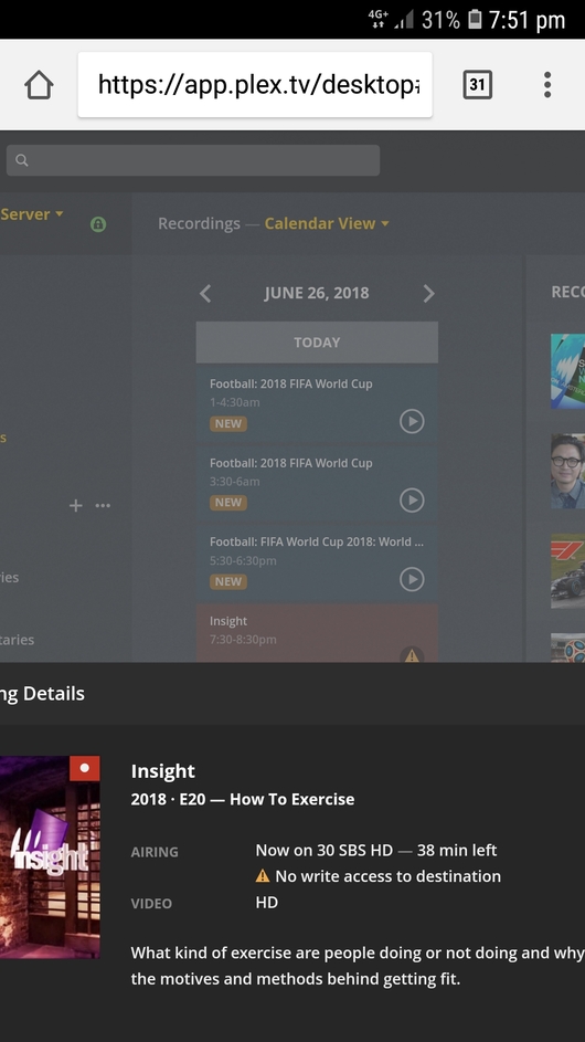

Dave - I’m also trying troubleshoot a “no write access to destination error” on some recordings. I get it intermittently, user account running plex has full access to NAS directory where recordings are going, unless there’s somewhere else I should be checking privileges? I have two dual tuners configured with plex, maybe reason for intermittent issue relates to one tuner device vs another but I’ve tested 4 recordings simultaneously with no issues.
I’m afraid I’m not overly well versed in that sort of stuff. If you’re using Linux for your server, this might help.
https://forums.plex.tv/t/linux-tips/276247/10
