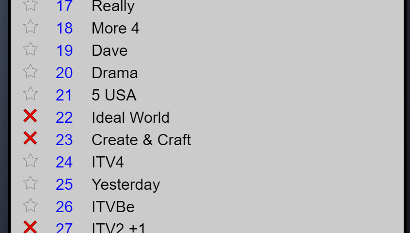

First page - shows channels numbered correctly, 19 for DAVE and 25 for YESTDAY

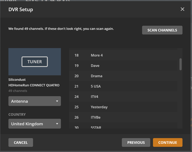

Next step - shows mapping incorrect. Dave is now mapped to “19 YESTDAY” which doesn’t even exist on the HDHomeRun
And if I try to correct the mapping, I can’t see Yesterday at all:

could you try to setup DVR / scan now. I am now seeing those channels on the right channel numbers
Thanks @sa2000, I am able to map 19 and 25 to the correct sources now. For me, this issue is resolved.
