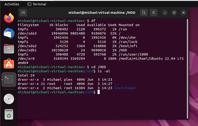

i am fairly new to linux/ubuntu, but i have been searching through all of the help with regards to adding a 2nd hard drive for media and getting Plex media server to see it.
so far i have followed steps to correctly install the hard drive, format it for gpt & ext4, edited /ect/fstab and the drive is easily accessible but not to plex media server.
i have followed steps to change permissions to the directory where the hard drive is mounted, though i have created a group “plex” it doesnt seem to be available as a option in folder permissions.
i have tried to change the default plex user but cannot find the application support directory in the default locations on my system.
bottom line i seem to be missing ways to make the mounted hard drive visible to plex media server as described in all of the permissions tutorials.
Please help

executed all commands, still cant see mounted drive.
This is a VM? (notice michael-virtual-machine)
Where is the HDD really connected?
yes that was a VM. i was using it for testing to solve the issue i am having with a physical machine without loss of data.
in the /ect/fstab i used the UUID that i puled from the blkid for /HDD mount point
That is bizarre.
What filesystem formatting is in use?
Also, which hypervisor and do you have raw passthrough of the device?

i learned from this. first the file system and location of plexmediaserver items was not present in the VM that i setup to solve the issue.
