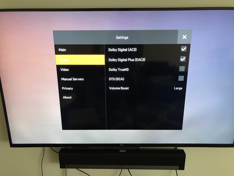

Yes but Plex can’t tell if there is actually sound coming out of your speakers. So you have to tell the Plex client, what the capability of your setup is. For example, see here, my Plex client on my LG TV, I have specified that it can’t playback DTS audio (first screenshot). On the second screenshot you see that I have a movie that has DTS audio. And on the third screenshot (via PlexPy) you can see that while I am playing this movie back on my LG TV, the Plex PMS transcodes the audio to AAC5.1 and sound is coming out of my Playbar! I hope this helps!
