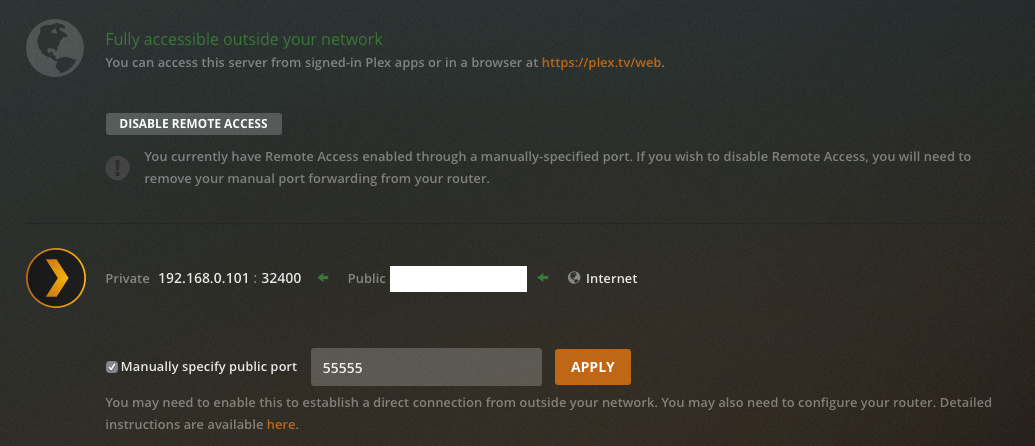

Are you saying that the “Public” IP shown in the area below on your server is an IPv6 one?
If so, that’s a new one on me. The IP address shown there is the one to which the Plex servers are attempting to connect. That is, what it believes to be your public IP. My understanding is that, given their state of IPv6 deployment, the only way Plex will attempt this is if you’ve specified an IPv6 address as the host in the URL configured in the Customer Server Access URL in the Network section of the server settings:

Also, the way your remote access settings are currently configured, you need to have UPnP enabled on your router for this to work. If you’d like to use a manual port forward rule you need to check the box “Manually specify a public port” in the Remote Access area.
Have restarted and it is now showing “10.0.0.81:32400”. However, I can’t connect to it except via 127.0.0.1 or via the internet
See the note I added to my post above. If you’re using manual forwarding rules in your router, check the “Manually specify a public port box” option. You can leave the default of port 32400 (just make sure your firewall rule expects that). As it is, PMS is trying to negotiate a port forwarding rule via UPnP.
