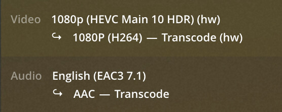

Yet when transcoding a video (1080p HDR HEVC in this example) I never see the GPU usage go over 3%, it usually hangs at around 1% while my CPU is practically melting. (I’ve seen the CPU usage go over 900% which I didn’t know was possible)
The dashboard indicates that Hardware Acceleration is in use (hw)

No idea why the Dashboard shows hardware decoding of HEVC video (the first (hw)).
Neither of the GPUs in your system is capable of such. HEVC decoding was not introduced until later products were released.
Both GPUs can encode to H.264, so it is normal to see the second (hw).
The Nvidia GT650M is based on their Kepler technology, released in 2012. A GPU based on Nvidia’s GM206 (Maxwell 2nd Gen, released 2015), Pascal (released 2016), or later is required to decode 10-bit HEVC video.
Intel added 10-bit HEVC decode ability to their 7th Gen Core chips. Intel 3rd Gen chips with HD 4000 graphics can decode H.264, MPEG2, & VC1 using Quick Sync Graphics.
By itself, the CPU It can transcode two H.264 1080p streams. It has a Passmark of 5651. A Passmark of ~2000 is needed to transcode H.264 1080p. A Passmark of 17000 is needed to transcode 4K HEVC without using hardware acceleration.
