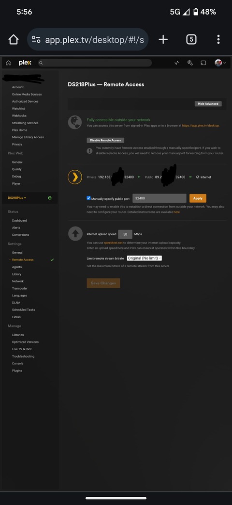

Using remote access for years. Mostly working. Suddenly stopped working. Checked the basic settings seems ok. Rebooted everything including router, no change. Works on local net, but not away from local LAN. But app.plex.tv works fine even when away from LAN which suggest the server is accessible.

I am using a fritzbox with the following port forwarding rules (like i said this has worked for me for years now) so i’m a bit hesitant to change them.

But when I use my phone to hotspot and give wifi to my computer (to simulate being on external network), both the app and app.plex.tv work.
On my wifes iphone it’s the same issue as on my android. The Plex app works on wifi but not on cellular. But app.plex.tv works when used in the browser. So I think i’ve managed to rule out a single player or single phone settings as being the cause. Also pretty sure the server is accessible outside otherwise app.plex.tv wouldn’t work right? Also important to note that Plexamp works fine on external network and LAN. What am i missing?
