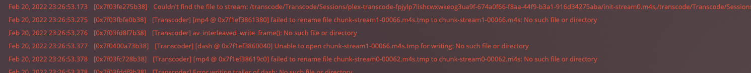

I’ve been getting a transcoding error very sporadically for a few weeks now on different devices and different servers. The error is very difficult to reproduce.
The log for this looks like this:
Server performance (CPU Ryzen 5900X GPU Quadro P4000) can be ruled out. The error also occurs in Direct Stream (when only audio needs to be transcoded).

i hope this log helps more:
Mar 16, 2022 14:28:41.661 [0x7f6c669aeb38] DEBUG - Removed transcode data consumer, active count 0 => 0
Mar 16, 2022 14:28:41.720 [0x7f6c5f28db38] DEBUG - Request: [*. * . * . *:33654 (WAN)] GET /video/:/transcode/universal/session/32c99d985cda0779-com-plexapp-android/base/00021.ts (34 live) Signed-in
Mar 16, 2022 14:28:41.720 [0x7f6c5f28db38] DEBUG - [Transcode/32c99d985cda0779-com-plexapp-android] Asked for segment 21 from session.
Mar 16, 2022 14:28:41.720 [0x7f6c5f28db38] DEBUG - [Transcode/32c99d985cda0779-com-plexapp-android] Returning segment 21 from session
Mar 16, 2022 14:28:41.720 [0x7f6c5f28db38] ERROR - Couldn’t find the file to stream: /transcode/Transcode/Sessions/plex-transcode-32c99d985cda0779-com-plexapp-android-78d29781-f888-4835-8366-8a5f90c76559/media-00021.ts
Mar 16, 2022 14:28:41.720 [0x7f6c6698bb38] DEBUG - Completed: [*. * . * . *:33654] 404 GET /video/:/transcode/universal/session/32c99d985cda0779-com-plexapp-android/base/00021.ts (34 live) 0ms 240 bytes
Mar 16, 2022 14:28:41.720 [0x7f6c669aeb38] DEBUG - Removed transcode data consumer, active count 0 => 0
Mar 16, 2022 14:28:41.780 [0x7f6c65aedb38] DEBUG - Request: [*. * . * . *:33655 (WAN)] GET /video/:/transcode/universal/session/32c99d985cda0779-com-plexapp-android/base/00022.ts (34 live) Signed-in
Mar 16, 2022 14:28:41.780 [0x7f6c65aedb38] DEBUG - [Transcode/32c99d985cda0779-com-plexapp-android] Asked for segment 22 from session.
Mar 16, 2022 14:28:41.780 [0x7f6c65aedb38] DEBUG - [Transcode/32c99d985cda0779-com-plexapp-android] Returning segment 22 from session
Mar 16, 2022 14:28:41.780 [0x7f6c65aedb38] ERROR - Couldn’t find the file to stream: /transcode/Transcode/Sessions/plex-transcode-32c99d985cda0779-com-plexapp-android-78d29781-f888-4835-8366-8a5f90c76559/media-00022.ts
Mar 16, 2022 14:28:41.780 [0x7f6c669aeb38] DEBUG - Completed: [*. * . * . *:33655] 404 GET /video/:/transcode/universal/session/32c99d985cda0779-com-plexapp-android/base/00022.ts (34 live) 0ms 240 bytes
Mar 16, 2022 14:28:41.780 [0x7f6c669aeb38] DEBUG - Removed transcode data consumer, active count 0 => 0
Mar 16, 2022 14:28:41.842 [0x7f6c65db2b38] DEBUG - Request: [*. * . * . *:33656 (WAN)] GET /video/:/transcode/universal/session/32c99d985cda0779-com-plexapp-android/base/00023.ts (34 live) Signed-in
Mar 16, 2022 14:28:41.842 [0x7f6c65db2b38] DEBUG - [Transcode/32c99d985cda0779-com-plexapp-android] Asked for segment 23 from session.
Mar 16, 2022 14:28:41.842 [0x7f6c65db2b38] DEBUG - [Transcode/32c99d985cda0779-com-plexapp-android] Returning segment 23 from session
Mar 16, 2022 14:28:41.842 [0x7f6c65db2b38] ERROR - Couldn’t find the file to stream: /transcode/Transcode/Sessions/plex-transcode-32c99d985cda0779-com-plexapp-android-78d29781-f888-4835-8366-8a5f90c76559/media-00023.ts
Mar 16, 2022 14:28:41.842 [0x7f6c6698bb38] DEBUG - Completed: [*. * . * . *:33656] 404 GET /video/:/transcode/universal/session/32c99d985cda0779-com-plexapp-android/base/00023.ts (34 live) 0ms 240 bytes
Mar 16, 2022 14:28:41.842 [0x7f6c669aeb38] DEBUG - Removed transcode data consumer, active count 0 => 0
