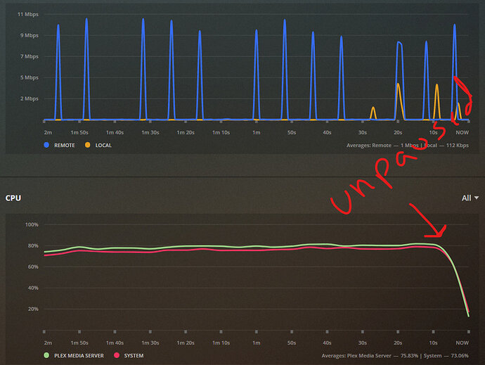

Image showing 80% cpu, nothing else going on except the 1 paused local stream and it being canceled @ 20seconds in:

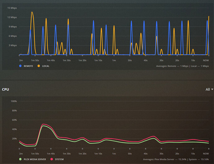

Image of a session being paused and it starting to stair step up slightly. One more user did start playback, but they are very steady cpu at this point.
A couple minutes later, CPU continues to climb, no additional users, just 1 remote with low steady cpu and 1 local paused eating cpu.
so this time instead of killing the stream, i just unpaused it at the tv and it released the cpu after about 30 seconds of playing.
playback and cpu seem fine as long as nothing is paused:
