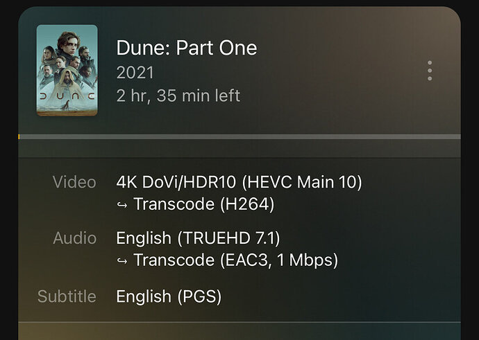

In my case, i have the plex server on a ubuntu VM and plex player on my LG TV. When i run certain movies, it does transcoding, like this example:
i see in this case video codec HEVC Main 10 is being transcoded to H264, but why because i have other media HEVC which is not being transcoded.

Yes. It’s the client capabilities that determine transcoding.
What media formats are supported on Smart TVs? | Plex Support (This was the first result from googling “Plex codecs”…)
The first thing I’d check in your case is whether the movie has an alternative audio stream, such as EAC3. If it does then change the playback settings to use that audio stream, rather than the TRUEHD stream. That may solve the issue.
yeah man, you were right. i do have an alternate audio stream which is AC3 5.1 and when i manually changed to it, it works normal. Thank you.
How did you know that the audio was the problem and if only that was the problem, then why did it do transcoding for video also?
Based on these facts, i imagine that an external media player like nvidia shield or apple tv, would be a huge improvement for the codecs list, correct?
Experience mainly. And the video was likely transcoded because of the subtitles. It’s not uncommon on a lot of devices that if the audio is being transcoded and there are subtitles then the video will also be transcoded. I believe it has something to do with keeping everything in sync.

May very well be the subtitles. Try disabling them and leaving the audio on TRUEHD.
ok tried that: disabling the subtitles completely still does transcoding on audio from TrueHD to EAC, but it does not transcode video any more. So still audio transcoding, but at least it is manageable; the server does not go in high cpu/mem with long buffering like it did in the first case.
You’re running into limitations of the LG TV, the Plex SmartTV app, and Plex Media Server.

No TV supports TrueHD audio (LG, Samsung, etc). When using the Plex SmartTV app, it is transcoded to a supported format. This also applies to TVs using the Plex AndroidTV app (Sony, etc.).
Some TVs do not support DTS audio formats. If DTS is not supported, when using the Plex SmartTV app, it will be transcoded to a supported format.
LG removed support several years ago, but recently added it back starting with the 2023 models. You can check the tech specs for your model (or the review at rtings.com) to see if DTS is supported.
HDMI-eARC audio passthrough
Note: Both the TV and the attached receiver/soundbar/etc must support HDMI-eARC.
No TV supports TrueHD passthrough from a TV based app.
LG TVs support TrueHD passthrough for devices attached to an HDMI input on the TV.
If the LG TV supports DTS audio, it will passthrough DTS over HDMi-eARC from both TV based apps and devices attached to the TV’s HDMI input.
If the LG TV does not support DTS audio, it will not passthrough DTS from either TV based apps or HDMI attached devices. DTS will be transcoded to a supported format.
Plex LG SmartTV app, subtitles, and Plex Media Server
When using the Plex LG app, if the media is direct streaming, such as when audio is transcoding, enabling any type of subtitle results in a video transcode.
In addition to the video transcode, Plex Media Server burns the subtitles into the video stream. Subtitle burning uses the CPU, even when using hardware accelerated transcoding.
If the CPU cannot burn subtitles in real time (common with 4K media), the end user experiences buffering.
Note: “Subtitle burning” is the process of adding the subtitle to the video frame instead of sending it as a separate track. PMS decodes the video, then adds the subtitle to the video frame, then encodes the video to the desired format. The process occurs frame by frame.
