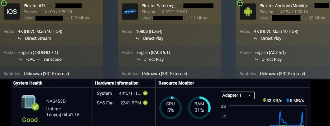

The NAS had no problems with 3 devices connected and direct streaming at the same time(screenshot1).
When Direct Streaming, the app showed transcoding is done on the NAS(screenshot2). Is this considered hardware or software transcoding as i don’t have PLEX PASS yet?
I don’t think i need to do anything with it as it seems to work ok by itself. I don’t know what a docker is…

I have now tested the plex app on Android and IOS and the results are good. If the device does not support the respective audio codec it will transcode it to either AAC(Android) and FLAC(IOS).
This leads to the video being streamed, not direct played but both phones’ plex apps handled this beautifully with not much delay and the Nas CPU only spiked at the start or when seeking another chapter via the player timeline, even with 3 devices steaming at the same time.
Subtitles on or off didn’t make any diffence on these devices, external srt or internal embedded srt’s did not make the player to stream or transcode.

Transcoding problems and PlexPass:
I managed to play DTS content with SRT and PGS subs by unchecking Disable video stream transcoding in Plex transcoder options.
No longer gives an error and with a little buffering at the beginning; the Qnap CPU load was at around 95% with all 3 Plex apps(2 CC + LG) playing the same transcoded 1080p movie and tv show.
I got 1 month PlexPass and enabled HW Transcoding and encoding:
The same files that worked great with SW Transcoding now are unplayable with 1 min of buffering for 1 sec of content then buffering again, but at least the Nas CPU is at 40% load :roll_eyes:
Tried signing out and signing back in on the apps, tried all transcoder quality settings, with encoding off, no luck.
My Nas should work with HW transcoding as stated by PLEX:
So if a solution isn’t found i will keep HW Transcoding off and use the PlexPass only for skipping intros and HDR tone mapping until it expires.
BTW I see no difference with HDR tone mapping ON as opposed to before.
