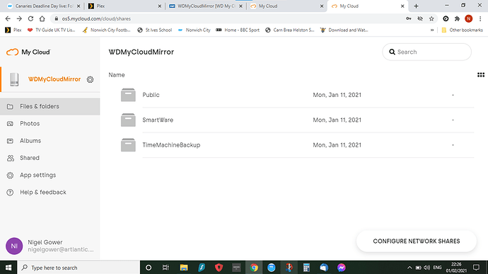

many thanks again uninstalled both again cleared regedit and appdata cleared services - it seems to be the recycle bin and the reinstalled - libraries still there something is being remembered somewhere
screenshots in case have misunderstood

It seems the tab/section on the WD My Cloud interface referred in the support article is called Apps. Did you disable the Plex service there?
Ok will not not do anything in Windows. Yes disabled in apps and have also uninstalled neither remove the libraries.
