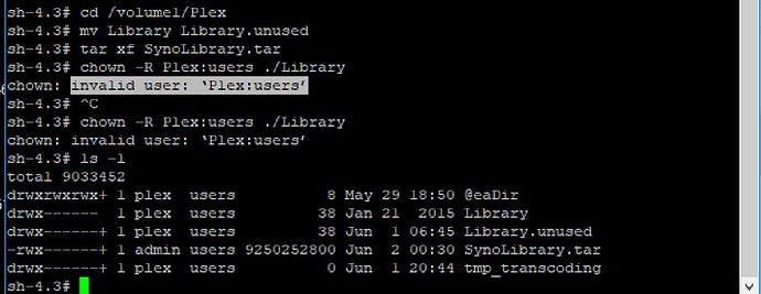

however at the last step in the new NAS after I executed tar xf SynoLibrary.tar
I started chown -R Plex:users ./Library
I got an error
invalid user" Plex:users’
what did I do wrong ?
GACK!
plex:users
That one’s on me. SORRY! <facepalm>
this is ls-l comand in NEW nas plex directory
Adjust for maximum smoke (start the package) :slight_smile:

Your the MAN :slight_smile: thanks im not very familiar with linux but i know its case senstive didnt want to try anything untill i got your feedback
