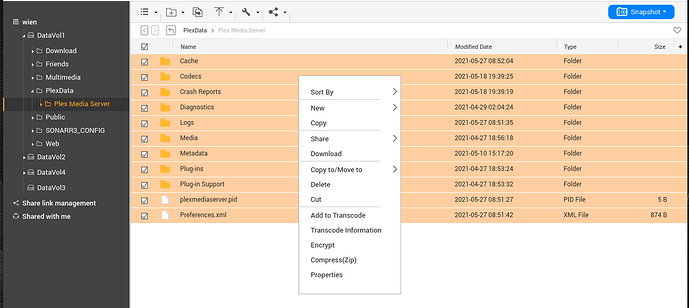

Yes, it’s that easy.
  1. File Station → PlexData → Plex Media Server
  2. Stop Plex
  3. Highlight all the files in the “Plex Media Server” directory and make a tar.gz or ZIP file
  4. Done.
