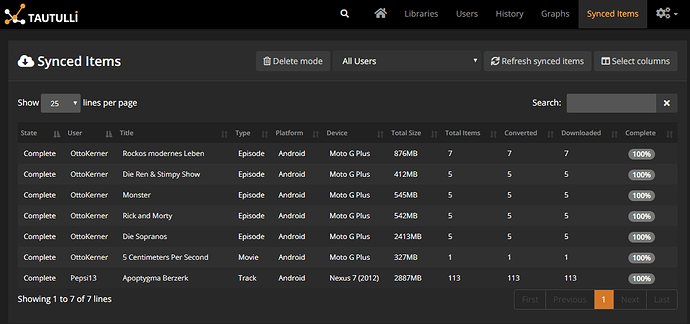

Who is responsible and for which apps the Sync job was created, you can see only with Tautulli, atm. It has a separate section called Synced Items.
Only sync jobs where the ā€˜Downloaded’ column has a lower count than the ā€˜Converted’ column are actually taking up space on the server.
The screenshot below shows actually only sync jobs which are not taking up space on the server, because they are all download completely to the devices. (100% complete)
Only the user who created the sync job can clear it out again.
If the target device is no longer available, use the web app.
Settings - Status - Sync
Or use Tautulli. :slight_smile: (ā€˜Delete Mode’)
