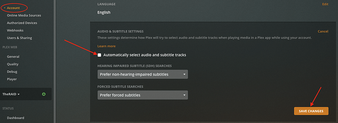

The subtitle issue, try Settings - Account - Audio & Subtitle so that it’s 100% manual.
Uncheck that box and Save. Try the playback again.
When it burns subtitles, that can easily cause stutter.
