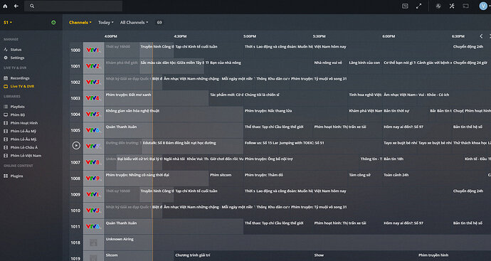

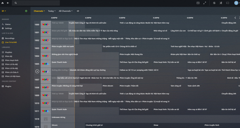

I am Vietnamese, i use iptv with xteve on plex, it’s ok.
do you install plex in server window?
can u scan with soft hauppauge WINTV? how many channel scanned?
