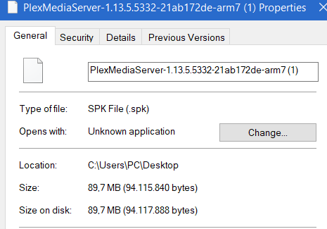

Im stuck in the Synology settings on the Pacage Sources.
I have to tipe in the Name: and the Location:
When i try to tipe in the Location it is “Invalid location”
For the name i use: PlexMediaServer-1.13.5.5332-21ab172de-arm7 (1)
And for the Location: https://www.plex.tv/media-server-downloads/
What did i do wrong?

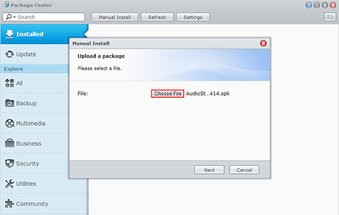

Option 2: Manual Install
UI of the current version looks slightly different – functionality and buttons are the same. => This is referring to chapter 2.3 of the link I had posted above.
  1. Open Package Center
  2. Click Manual Install
  3. Click Choose File to select the install file you had downloaded before
  4. Click Next
  5. In the following dialog you might be asked to Run Plex after the installation
404 Not Found
After instalation it does not recognize Plex.
I’m getting the 404 error
SOLVED !
Did the whole thing again, i download the file again and it worked!
