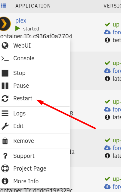

I don’t know if my experience applies to Synology devices but my Docker install will look for and retrieve the latest version when I restart the docker. Mine is running under unRaid but I would assume the docker behavior would be the same?
Screenshot_1
