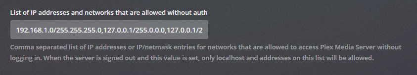

i don’t own a QNAP, but allowing local without auth is doable.
Settings>network>advanced>List of IP addresses and networks that are allowed without auth
here enter local ip addresses, or netmask for the entire network.
192.168.1/255.255.255.0

Nah, that’s more to do with asking the user for a PIN when they try to access from a device on a given network.
I’m talking about how any access to your PMS has to go via app.plex.tv in one way or another. If you’ve got no Internet, or the Plex services at that URI are having a bad day, you can’t access the data on your local server with a Plex client.

sekthree reporting back.. ok so.. I pulled the internet cable going into my router and tested several “apps” for connectivity. I tried to take as best screen shots and photos as i could. The end result was, i was able to access my Plex server without internet.

My Plex settings
