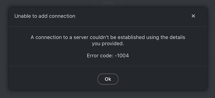

Wow! Thanks for the quick response @chrisallen. Here’s the commmand and response:
$ wget -qO- http://localhost:32400/identity
wget: cannot connect to remote host (127.0.0.1): Connection refused
Going through one of the apps, I also tried to manually add the server without success. Maybe the error code helps though.
Error code: -1004
