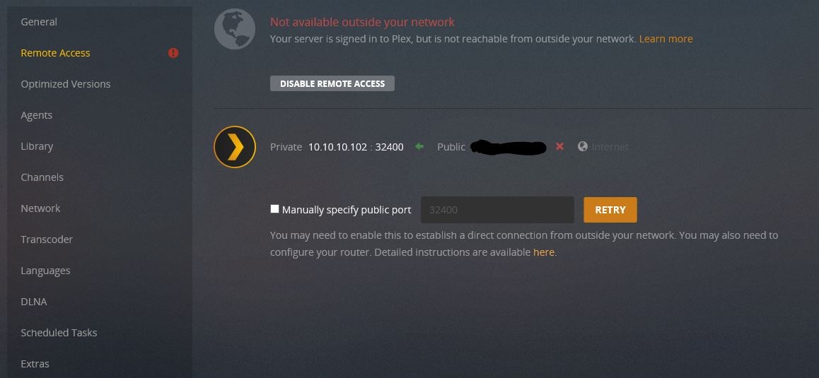

I CAN access Plex from outside my network, but Plex is saying I CAN'T?
I CAN access Plex from outside my network, but it states that I CAN’T? What is going on here? Why would it say this?

I tried manually setting to 32400 in the Plex menu and it still says can not connect from the outside. LOL this is weird.

For better error diagnosis,
activate debug logging (not ‘verbose’!)
Please disable PAT in your firewall again.
If you don’t use the default Windows Firewall, make sure these ports are all open:
https://support.plex.tv/hc/en-us/articles/201543147-What-network-ports-do-I-need-to-allow-through-my-firewall-
(this list applies only to the firewall of the Plex server, it applies not to the firewall in your router!)
Go back to a manual port forwarding with an external port number of your choice
to internal port #32400 (only ‘TCP’ necessary)
set this up in your router
put in the external number under Settings - Server - Remote Access
tick ‘Manually specify public port’
then click on Retry
wait ~ 2 - 3 minutes
Please disable custom certificates and/or domain names for now (just in case you have set them up).
You are not using any kind of VPN or proxy software?
Let’s continue further diagnosis afterwards.
