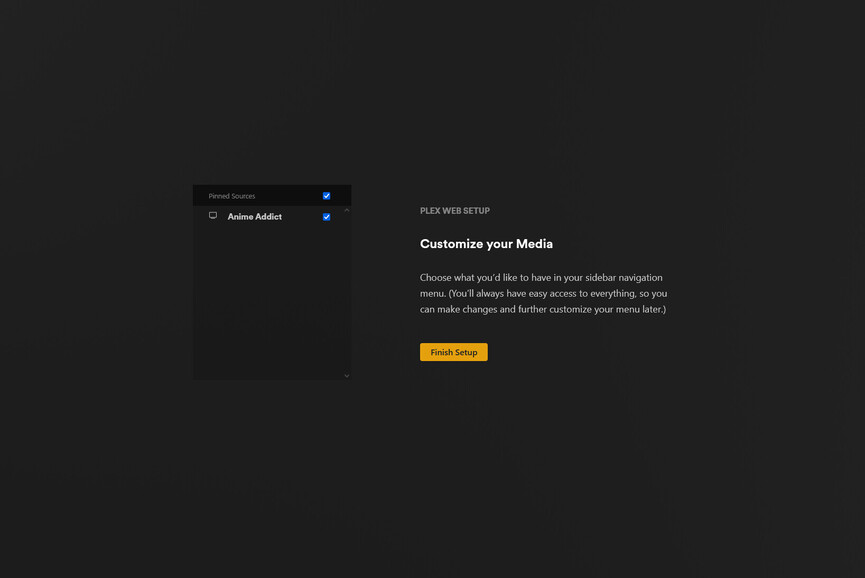

Okay, I’ll do my best to explain everything as concisely as possible to avoid overwhelming details or losing track of the key issues.
Ever since my Plex account was hacked—even though I eventually regained access—I’ve encountered persistent problems. Specifically:
  1. I can’t log into my server.
  2. Worse, I can’t create a new server at all.
I’ve tried everything imaginable:
  • Followed troubleshooting guides step by step.
  • Cleared the cache.
  • Edited and deleted registry entries and preference files.
  • Searched for hidden options to tweak settings manually.
Despite all this effort, nothing works—no matter which computer or NAS device I use, whenever I log in through my account, I always get the same frustrating error message: “You are not authorized to access this server.”
Oddly enough, when I created a completely new Plex account and set up a server on a different computer, it worked flawlessly without any issues. This seems to suggest it’s not an account issue but rather some kind of software problem specific to my original setup.
However, here’s where I’m stuck: how can it be a software issue when I’ve tested seven different computers and four separate NAS devices? Surely they can’t all have identical problems! Something deeper is going on here that I just cannot figure out—and honestly, I’ve reached my breaking point.
At this stage, I’m ready to give up entirely and request a refund unless someone can provide help or guidance because I truly cannot keep doing this anymore
|code|1001|
|message|User could not be authenticated|
|status|401|
