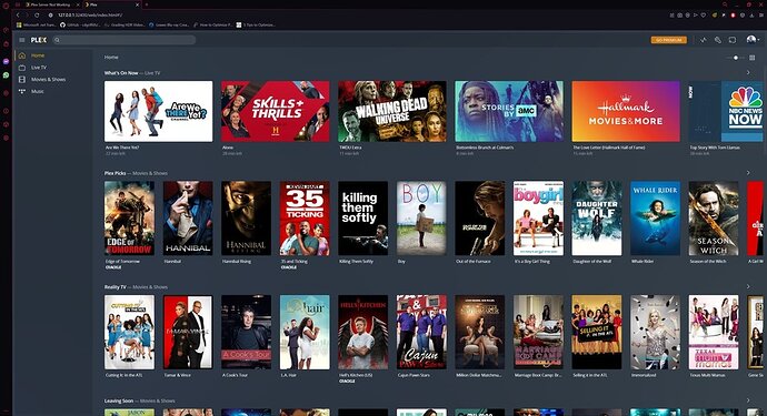

Im seeing a lot of WARN - [HttpClient] HTTP error requesting GET https://<IP>.plex.direct:21106/identity (7, Couldn't connect to server) (Failed to connect to <IP>.plex.direct port 21106: Connection refused) messages. Are you using a VPN? if you open an incognito tab What does http://127.0.0.1:32400/web show? Has your ISP changed recently?
I do use a vpn but i turned it off while dealing with these issues. the ip address link you sent brings me to the main page but still no server
the logs are showing the server is logging into your other account. so logging into the web app with your account ironspiderp won’t show it.
when you uninstalled server did you remove registry settings? that is where it would have got the login info.
