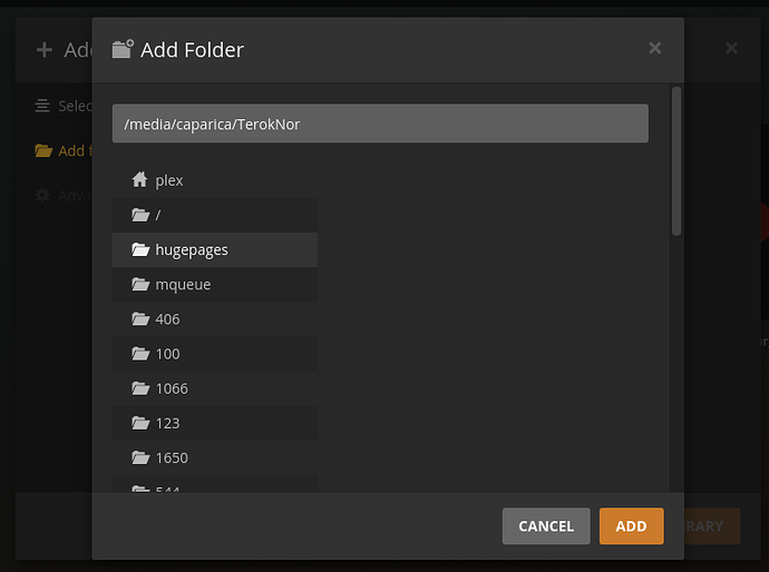

Now that I can make plex see the files that are on the local disks on this computer that runs Linux / Ubuntu, I still need to make plex also see the files that are in a shared folder (smb) on a NAS that I have here on the same local network.
On ubuntu, my user (caparica) already has access (nautilus) to the files. But through the interface to add libraries to plex, no folder appears inside the volume mounted on linux …
see image…
Any extra help is welcome!
You will need to have a permanent mount setup to the NAS that survives a restart. You will need to add an entry in your /etc/fstab to do this. A google search will help you. As before, you have to ensure that the plex user has read and execute perms to the directories on the NAS mount. If you plan to record TV, you will need write access too, but I would not recommend trying to record anything across the wire like that. I would record locally.
Hi Jwrober!
I already have (a few days ago !?) the NAS automatically mounted at boot via manual editing on the blessed FSTAB. :wink:
Even so, the contents of those folders are not shown to me … = /
