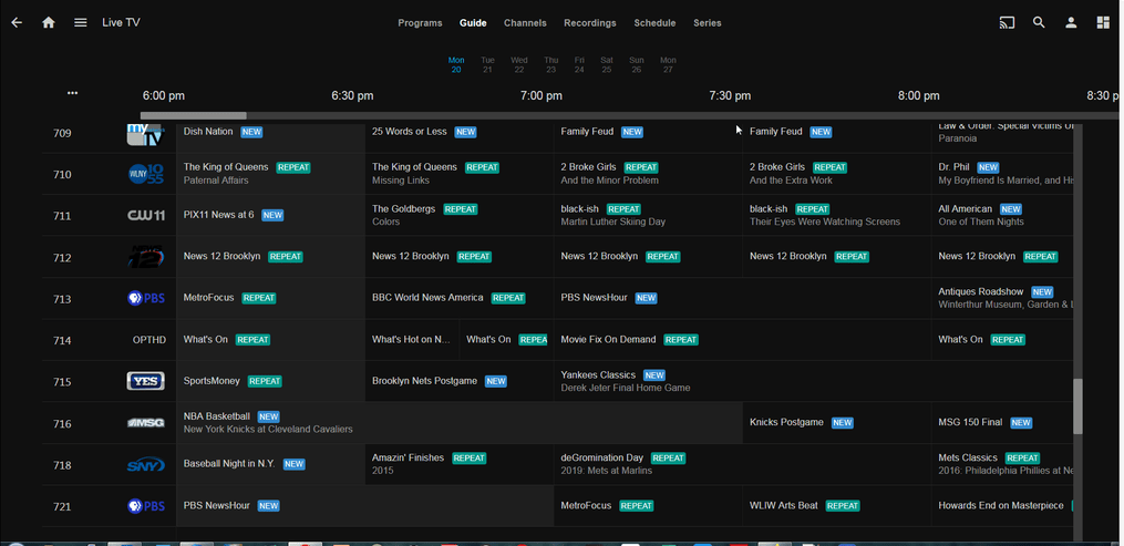

To be clear, my issue is that plex will not schedule new episodes for recording. This goes for all new episodes of almost every show (98% of them).
In addition, the lack of a “new” tag in 98% of the guide is also a mystery. As I’ve already posted the same xml works fine in Jellyfin.

I’l have to check again. I was told it should just be based on the “new” tag. However, looking at your XML sample above, that episode is not new.
<new />
This indicates the tag is empty, which means it’s not new. Maybe using Dr. Phil is a bad example. Can you provide the xml for that episode of Dish Nation from your screenshot above?
I was able to find this in the current guide. From what I can see if the new tag is alone, the episode is flagged as new.
If the new tag is with the previously shown it will not show as new.
