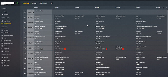

I’m not aware of any specific issues. Can you provide me a screenshot of the guide with the flag just incase these guides are doing something different.

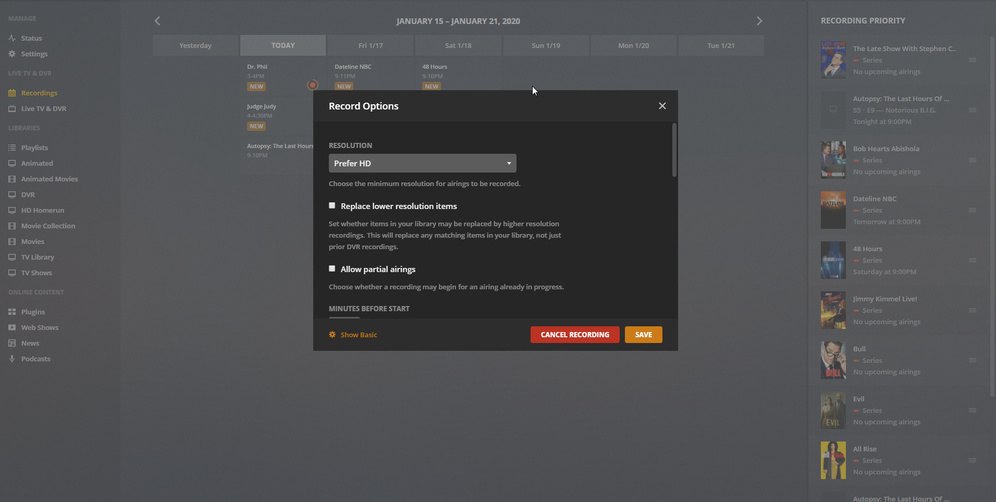

Providing two shots. Top is the grid showing new flag. Next is the schedule page showing only three shows scheduled for recording when all others are not (including Dr. Phil which in the grid is listed as new).
Also, not for nothing, but I think I know why the epg123 imported guide (shown above) shows the new flag and schedules direct guide does not. Is plex looking for that to determine if an episode is new or is it looking at episode number or air date?
