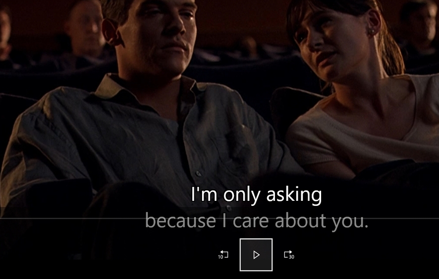

I need to use subtitles practically with every movie due to my old hearing. When the subtitle is long or complicated, I need to pause the movie.
The problem is that when I operate the pause (I use the space bar), the tool bar slides up and covers the subtitle, and I have to wait for it to come down.
The same happens when I start play again - the toolbar comes up again, completely unnecessarily, covering the subtitle, this time much longer.
The problem could be solved by moving the subtitles slightly higher, making the toolbar more transparent, or not raising the toolbar when the movie is paused by space bar.
The Windows store app is much better in this regard -
