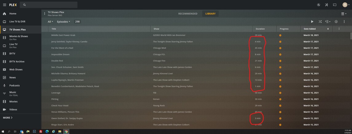

I’ve uploaded the last few days of my Plex recordings showing that 9 out of 14 shows Failed to record completely. I’ve uploaded a current log that should contain these activities.
Plex Media Server Logs_2021-03-18_11-58-43.zip (5.8 MB)
This has been ongoing since I started with Plex at the beginning of January 2021. Hoping that someone might have some suggestions as to what may be the problem. Plex Server is the only program running on this “clean” computer.
Might it be my tuner? My computer? Something in setup?
Thanks in advance for your advice.
