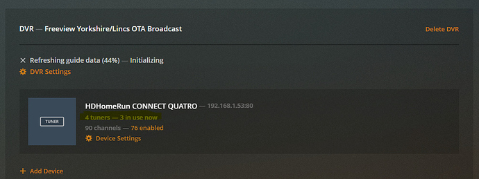

Plex is reporting 3 tuners in use whilst recording ITV1 (show also available in HD) whilst watching E4.
Annotation 2020-04-04 190425 Annotation 2020-04-04 190748
Setting 2 more programs to record Plex now states 5 tuners in use.
Which is obviously wrong.
Thanks for the screenshots. Would need server logs to go with screesnhots showing the issue. Ideally after a fresh relaunch of the server with debug logging enabled beforehand. This ensures logging is available from launch and the log would cover from period of no tuners in use

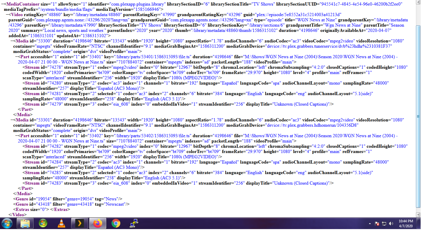

I am having a similar (same?) problem. Plex is indicating that it is recording the same show twice but only one file is saved in my library. However when I click on the “view HTML” button in the view info screen, I can see that two unique media grabbers are listed so that would lead me to believe that Plex has indeed tied up two tuners for the same show.
Server Version 1.18.9.2578 (Windows 10 Pro X64)

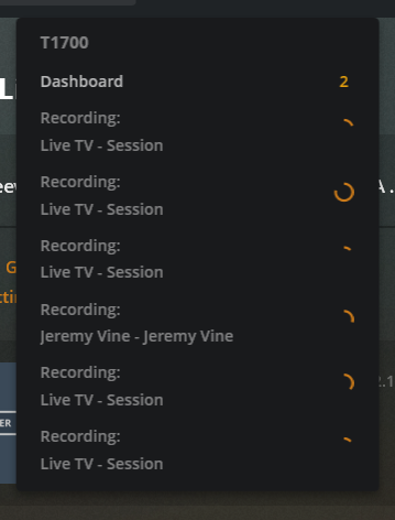

There was an error attempting to tune selected channel, please check you connection and try again. Quattro showing 6 tuners in use?
![image|604x187]
(upload://iZygISNiYjKPXhs217UR1bY6u0V.jpeg) Plex Media Server Logs_2020-04-09_09-45-00 (1).zip (6.6 MB)
You have verbose logging on which makes the logs difficult to read.
If you deleted and re-added the DVR to quickly for your system to finish database cleanup it ends up with leftover tuner information causing the duplicate sessions. You can try deleting the DVR, waiting 1-2 minutes and re-adding it but if that doesn’t cure it then Plex will have to find an alternative to wiping the database and starting fresh.
