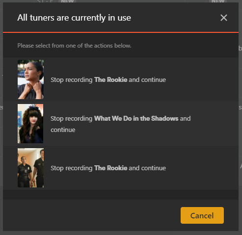

I still can’t watch live, but now it’s telling me it’s because “All tuners are currently in use” and asks me to choose one to cancel:
I only have two tuners, and yet Plex thinks it’s currently recording three shows, and is actually only recording one.
