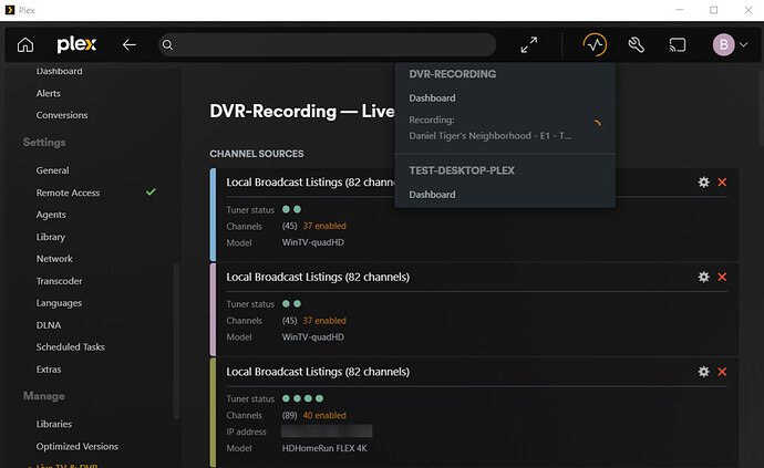

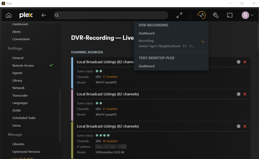

Do you actually see the dot color change when the tuner is used? My dots never change. Here is an example where a program is being recorded, but none show as being used. If I pull up the web interface for the HDHomeRun Flex 4K, I can see it is using one of those tuners, so I would expect that one dot in Plex would be changed. I tried another Plex server and it also did not change the dot color when tuning to a channel using my HDHomeRun EXTEND, so it appears to not work on either of my Plex servers on either of these tuners for me.
I do get a color change on the dot color - screenshot with one tuner recording one one tuner red/in use:
It looks like you are using Plex for Win (or Linux), and I’m also seeing no dot color change there, so it looks like a bug. Try the web app (https://app.plex.tv) and see if that shows the tuner use correctly.
Good call! The dots do update on the web app. Any idea of how a defect can be logged to get the desktop app to show correctly?
